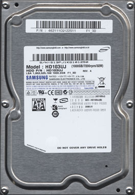

- Samsung SpinPoint F1 – HD103UJ (1AA01108)

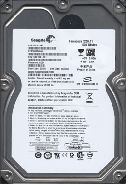

- Seagate Barracuda 7200.11 – ST31000340AS (SD03)

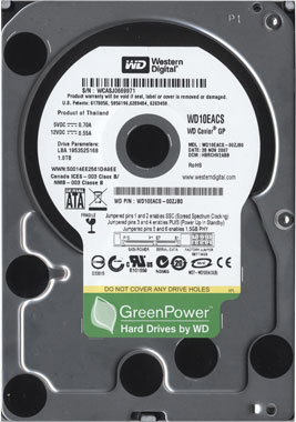

- Western Digital Caviar GP – WD10EACS (01.01B01)
