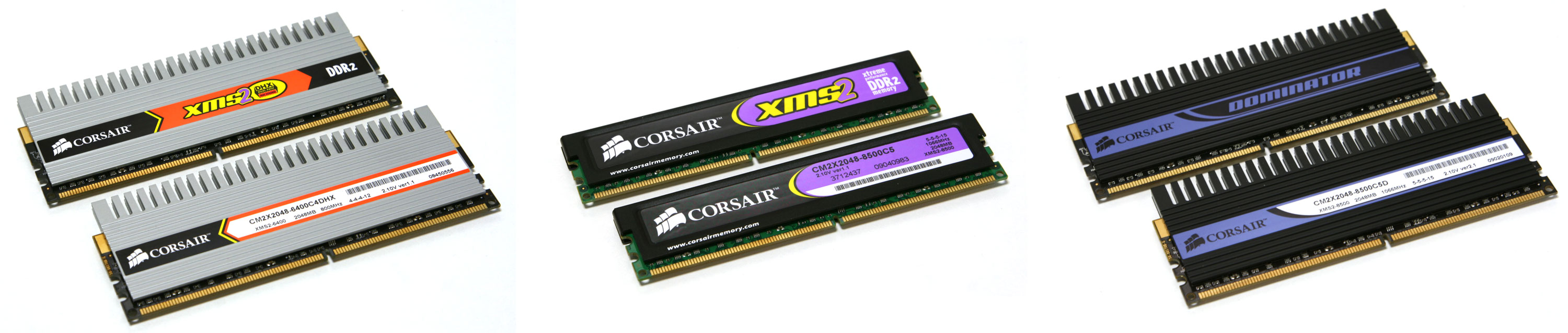

- Corsair TWIN2X4096-6400C4DHX
- Corsair TWIN2X4096-8500C5
- Corsair TWIN2X4096-8500C5D

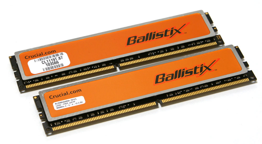

- Crucial BL2KIT25664AA80A

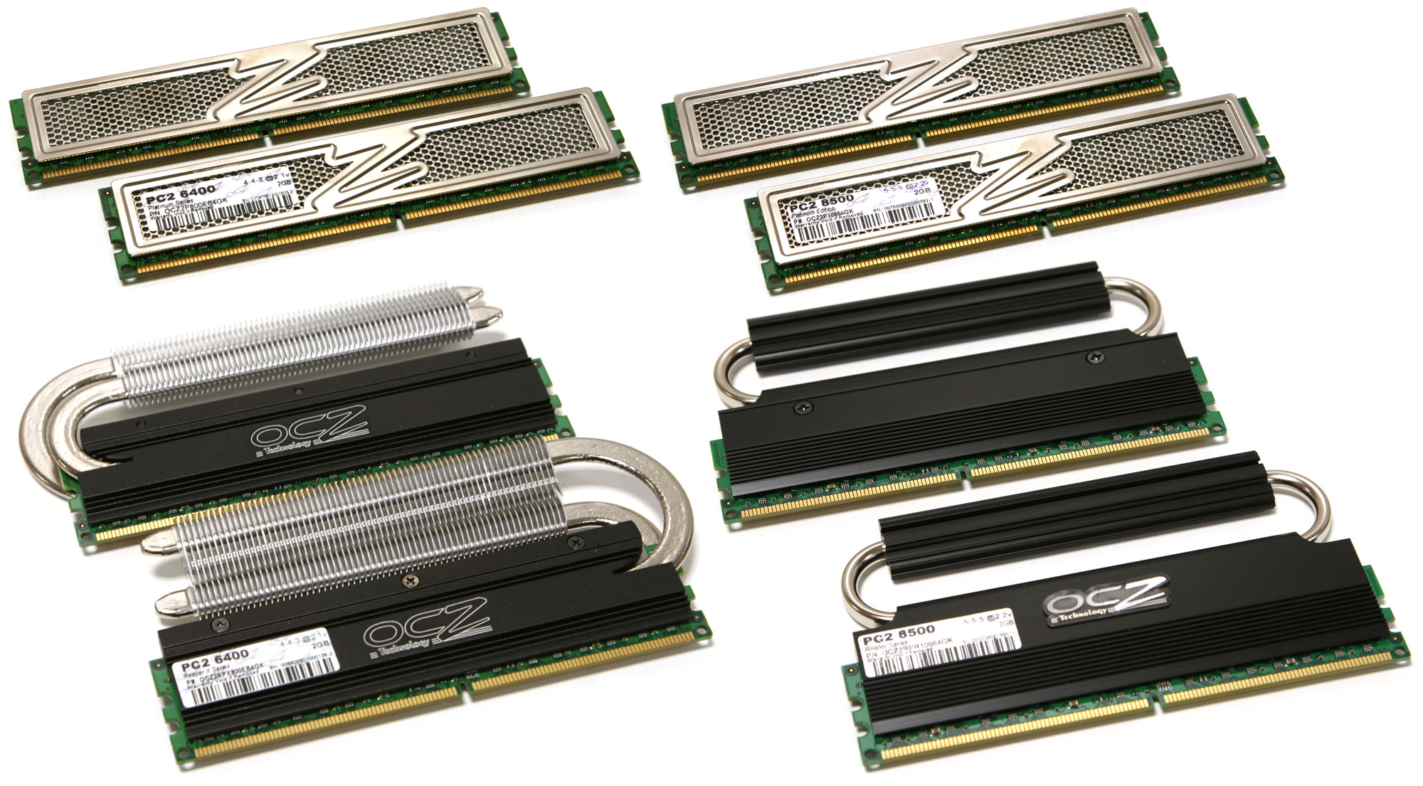

- OCZ 2P800EB4GK
- OCZ 2RPX800EB4GK
- OCZ 2P10664GK
- OCZ 2RPR10664GK
