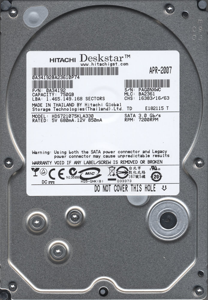

- Hitachi 7K1000 750 Go (GK8OA51D)

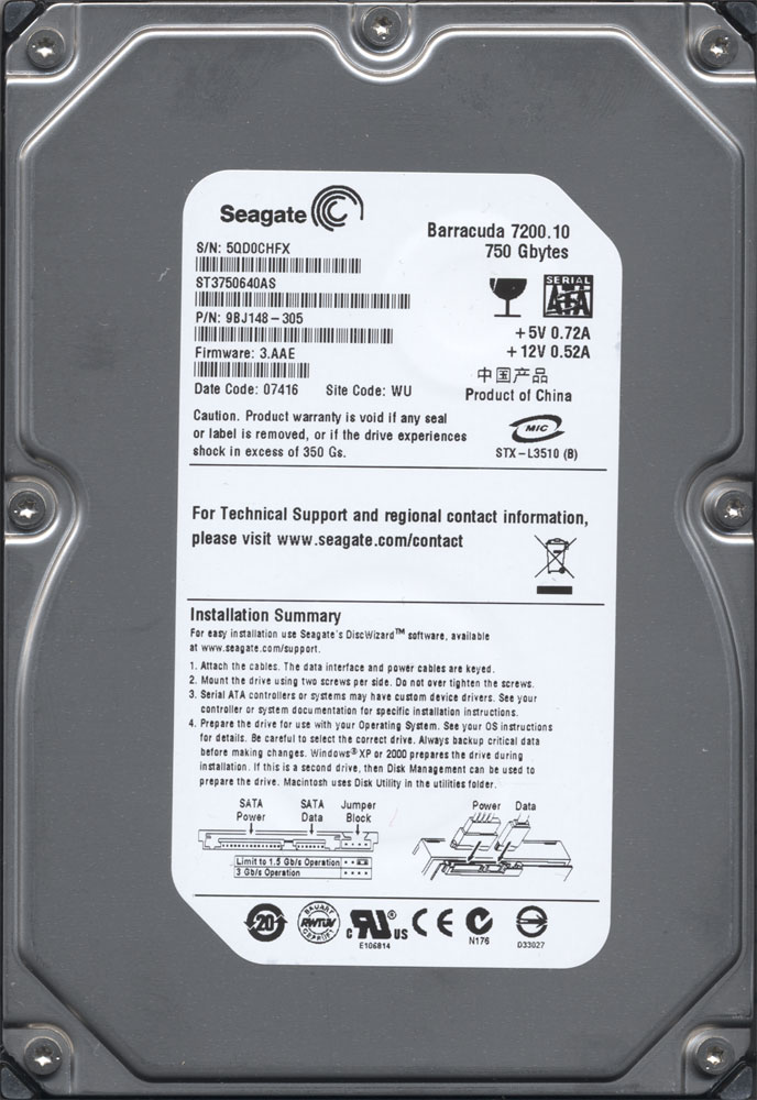

- Seagate Barracuda 7200.10 (5QD0CHFX)

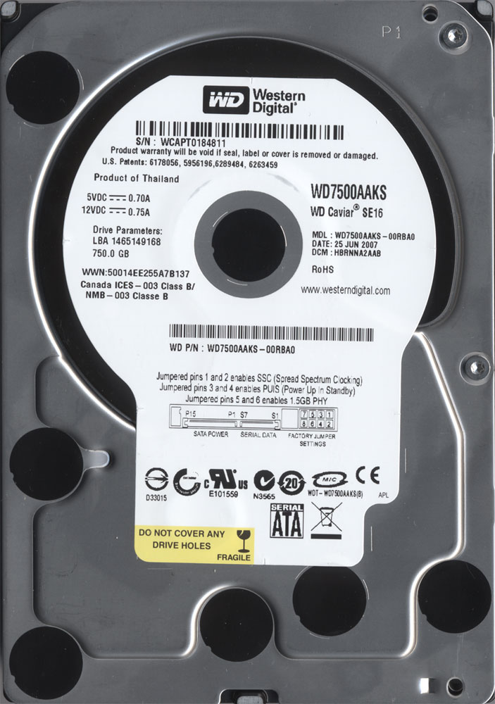

- Western Digital Caviar SE16 – WD7500AAKS (30.04G30)
